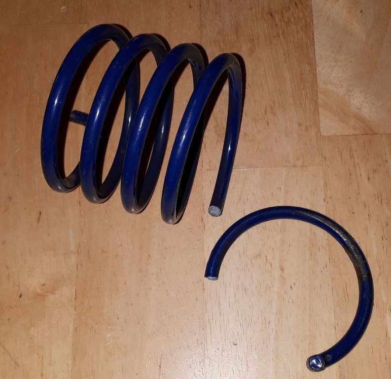

Friends Sr viper with TP blue secondary spring also broke off tang that was in the helix this weekend.
Pic of spring

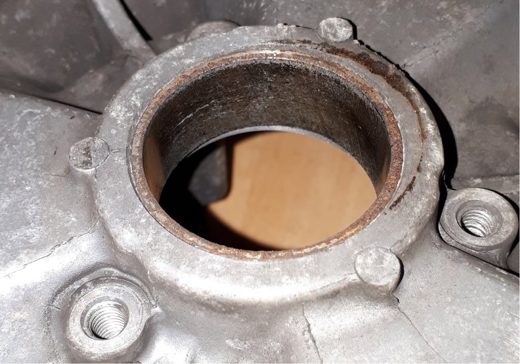

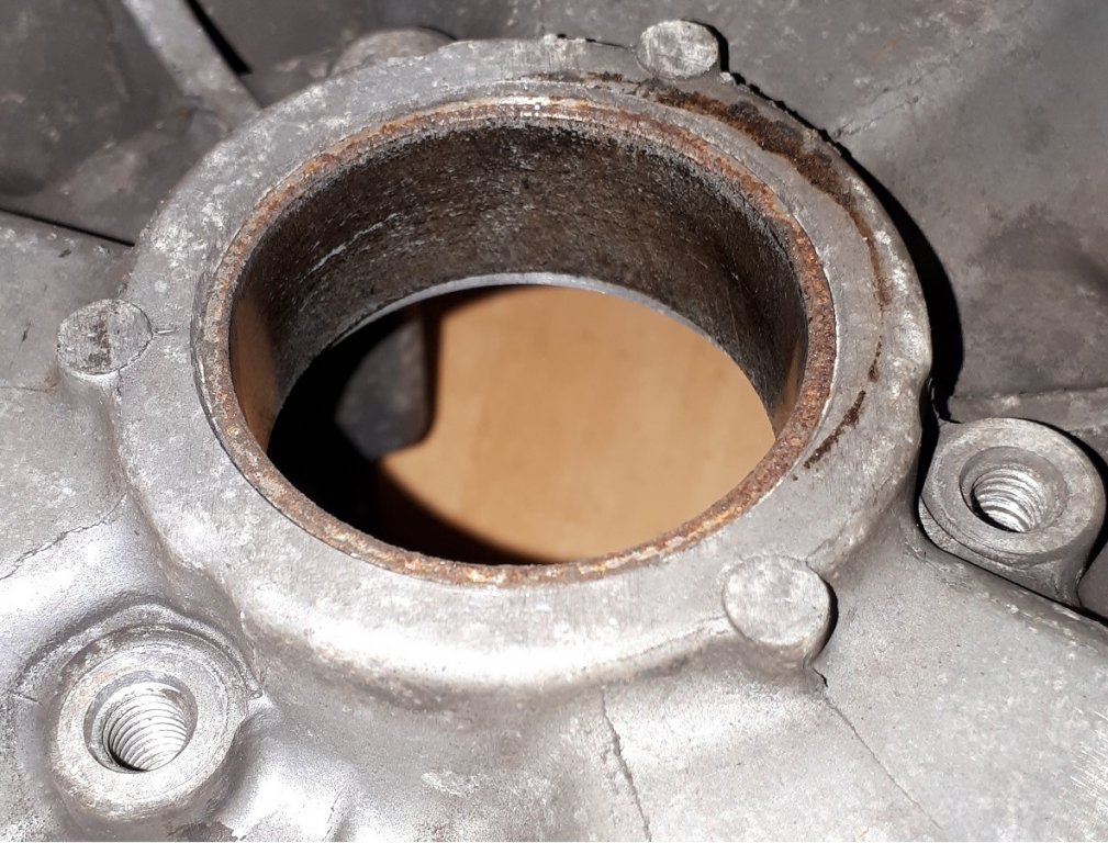

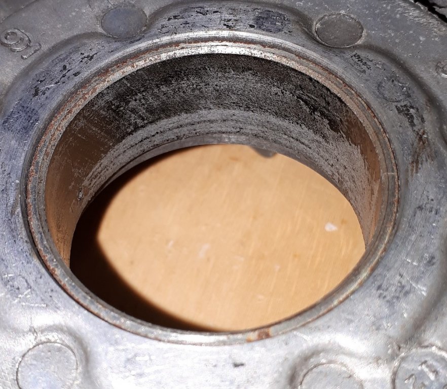

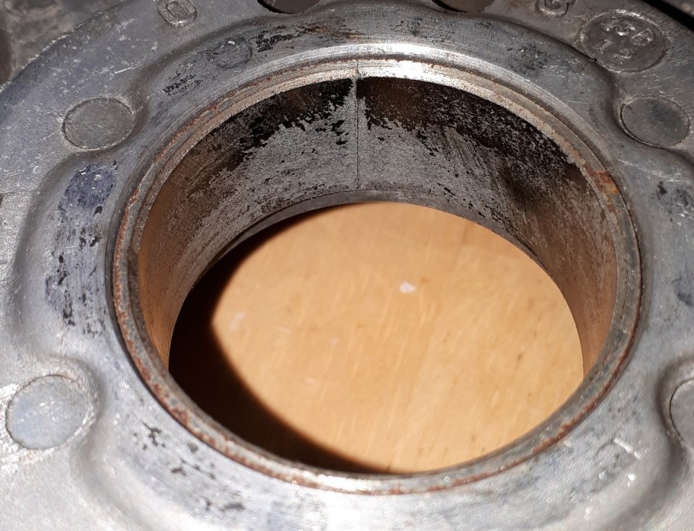

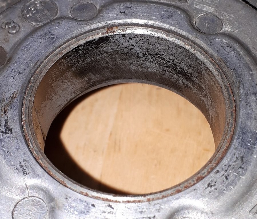

I didn't check the bushings for grooving. I guess I'll check that and if I don't find anything I'll throw it back together and hope that I just had some bad luck.
Take a pic of bushings.I didn't check the bushings for grooving. I guess I'll check that and if I don't find anything I'll throw it back together and hope that I just had some bad luck.

Glad you checked your secondary for play on bushings. There have been a couple of helix's losing their bushing. On another note, the stock springs are breaking because of the coil bind from factory. Our blue spring doesn't coil bind so I am thinking it was just a bad spring out of the hundreds we have sold.

Thank you for the pics. We, at Thunder Products Clutching want to know about these so we can contact our supplier to let them know.
All in all, springs go under a lot of stress, they do lose tension and can break.
