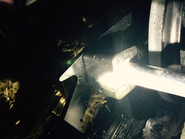

Not sure what this block is called back towards the end of the track....one side is broken almost all the way through and the other side has stress cracks.....2015 LTX DX 600mi
What is it called? Why did it break? And will it hurt to keep running it?

Looks like coupler blocks.
That is the coupler blocks, they're adjustable to change ski pressure and weight transfer, when you push on the rear bumper to collapse the suspension you'll see the flat spots on the rear arm that will eventually contact those blocks, be sure they are hitting flat and that the blocks aren't turned at a bad angle, if that's the case then I'm sure they could easily break.
Thank you sir...yes, much like other things on my sled they were not set right...plate contacts them exactly on the angle to cause them to break where they did.
I have no doubt thats what broke them. Its a 2 man job to adjust these. 1 person stands on bumper to compress rear suspension and other tightens the bolts. There is 3 positions 1,1,2,3
