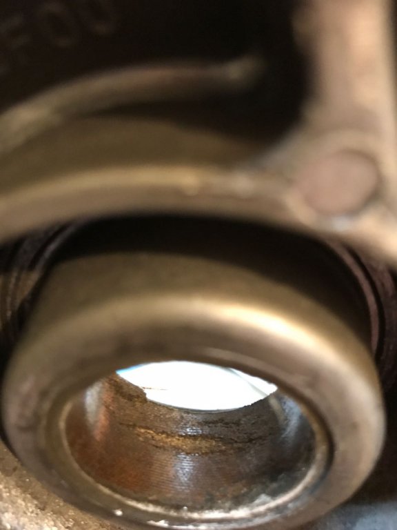

Mine primary spring is also gouged bad on the side, actual metal scraped off the side of spring, I have a blu/white/blu I put in and just did a loop on the yard it engages at 2600 rpm. Likely be a bit poochy on bottom, but should be close at high rpm. Will post how it works after this weekend.

I had ordered the TP glide washers earlier in the week and just got around to putting them in tonight. I definitely have signs of primary spring bind and THIS! The bearing has a huge gouge in it. WTF Yamaha??!! I was hoping to ride this weekend with the snow storm we have coming and doubt I should put this back on. Will call my dealer tomorrow and see if they have one in stock, otherwise this weekend is out

I destroyed my primary couple weeks back (self inflicted) was up in the UP tried to get a replacement clutch from all the dealer's within driving distance not any parts to be found.I had ordered the TP glide washers earlier in the week and just got around to putting them in tonight. I definitely have signs of primary spring bind and THIS! The bearing has a huge gouge in it. WTF Yamaha??!! I was hoping to ride this weekend with the snow storm we have coming and doubt I should put this back on. Will call my dealer tomorrow and see if they have one in stock, otherwise this weekend is out
View attachment 127151 .
Found a used 2011 salvaged Apex clutch swapped out the arms/springs, mounted it on with no issues road 480 miles.
Most current YXR clutch covers and or clutch works in a pinch.
I did have a EVO clutch kit in the Sidewinder and the arms where to long for the Apex spider however, there is just minor differences in the clutches as compared.
