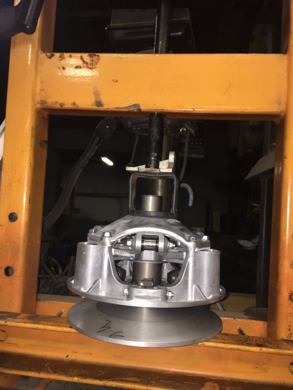

dgjr636
- Nov 16, 2013
- 314
- 396
- 618
- Clarence NY
- Sidewinder LTX LE
Pics of collapsed clutch. Hope you can seen there is still space between the coils.
actionjack
- Apr 9, 2005
- 2,519
- 623
- Westminster, Maryland
- www.inspectorjack.com
- 2017 SideWinder LTX-LE
First thing that pops into my mind from looking at your photo is it hitting the cover? Maybe glide washers or those bearings are the only answer. As a dealer who is candid with us here what is Yamaha saying? The broken springs are adding up.
