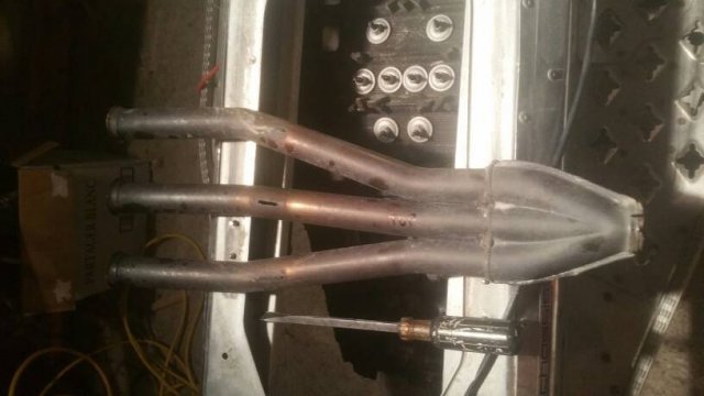

I'm in Ontario in kawartha lakes area.
See pic attached. I got out the ypipe!!
Looks like the bracket snapped off of it too. Not sure if this is repairable, but you can see the break in the pipe is very smooth. There is also light evidence of the tracks studs scraping the y pipe. Looks like at least a couple of times it scraped it.
Also one of my flex pipes appears to have broke as well.

Had the same thing happen last year, bought a hindle off of Dave a t hurricane. My Y Pipe is good and I'd be willing to let it go if you want another one...off a 2009 xtx. I'm by Beaverton. I might have one good flex pipe too.

Dont forget copper donuts. Your broken hanger would make it much easier to remove than if it wasnt broken. I find it easiest to install the flex pipes after you set the y pipe in place. Others are able to leave the flexpipes in. The y pipe has to be pushed in past the hanger then lift it up then pull it back. And take a real close look at your other flexpipes for cracks too.

Figure out what it all would cost then decide if you may want to go Hindle and see what that costs. Hindle will be much louder than stock if that is a concern for you. I think I eventually changed all my flexpipes, but I got an awesome deal on new set from a crate engine.
