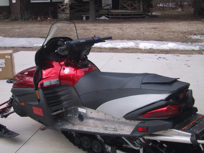

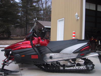

OK guys, I picked up the seat a few hours ago and finished the install. Now if I do this right you will see the Pictures.

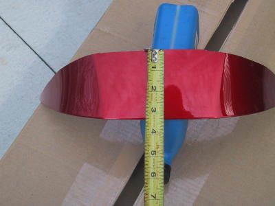

The measurement is 3 1/2 inches from the botom up in the middle of the cover. I took a pic of the piece I removed and it is about 3 1/4 inches. I used a 3 1/2 inch cut off wheel with a die grinder to make the cut.
I took a total of 6 pictures and these are all downsized quite a bit They wouldnt let me post the full sized photos. This is the first 3.
