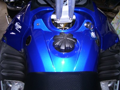

Sled Dog said:Did you have to cut 31/4 in off the front of the seat?
Off the tank shroud. Looks very factory and the seat tucks under nicely.
