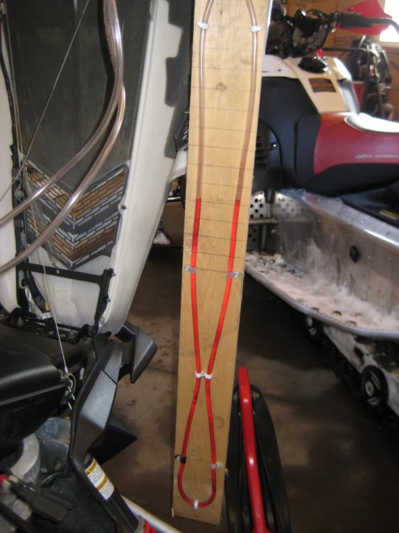

I made my own sync tool out of 12' of 5/16" vinyl tube filled with a little transmission fluid. I mounted the tube in a "U" shape on a 4' 1X4 pine board and filled it so I had around 22" of fluid in each side of the "U". You can only sync two carbs at a time but I've had good results with it. #3 carb (stator side) is preset so you sync 1 and 2 to it. There are only two screws to adjust (3 screws on 4 cylinder engines) which are located between 1-2 and 2-3. It's an easy adjustment that can make a big difference in performance.
Here are a few pictures of my Carb Sync Tool and it being used to sync the carbs on a Vector.
Note: never run the engine with only one side of the sync tool connected or you'll suck the oil out of the tube.
Hose connections are shown for adjusting carb #2 to the preset carb #3.
For this configurations adjust screw #2 until the sync tool is balanced then reinstall #2 fuel pump vacuum hose to the carb.
Move the T-hose over to #1 carb , reconnect the #1 fuel pump vacuum hose to the "T" and sync #1 carb to #3 preset carb by adjusting the #1 screw.

Carb #2 out of sync
Carb #1 slightly out of sync
Sync'd carb

Sorry I didn't get a chance to answer your questions before you put together the sync tool.
I used 12' total of 5/16 O.D. tubing which is just enough to mount it on the board and still reach the carb's. I cut about 4-5" off one end of the tube and inserted a tee for the fuel pump hose which is removed from the carb being sync'd.
I filled the tube with transmission fluid so that both sides have about 22" of fluid measured from the bottom of the "U". I found it easier to actually suck the transmission fluid into the line rather than trying to pour it in.
Syncing the carb's should be done at an idle with the engine at operating temperature (1350-1400 rpm). After each carb adjustment bring the engine rpm up then allow it to return to idle so that the carb settles. This is a differential type sync tool so all that matters when making an adjustment is that the fluid is level in both sides of the tube which indicates that the two carbs are balanced.
