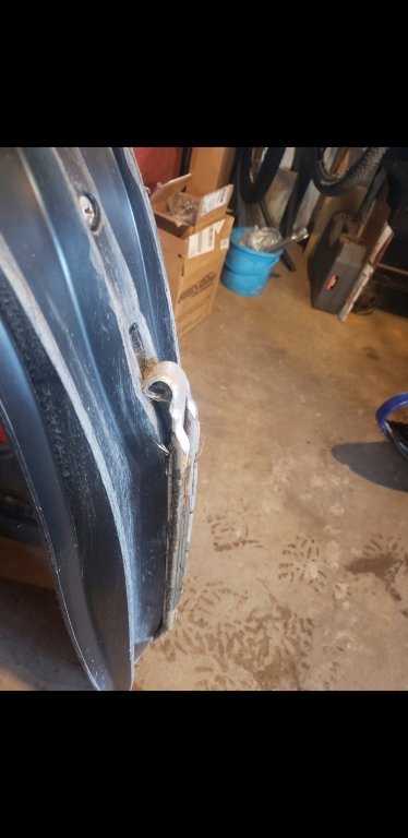

I tried to run those double carbide runners.
R R tracks stopped my sled in an instant.
No flex in the dual setup compaired to a single runner.
The dual runners will spear and send you for a ride...

Looks like you just got unlucky. I had dualies on the apex for awhile and never had any problems with RR tracks. Not even sure how you could do it considering the rounded profile of the top of RR tracks so you got very unlucky, maybe you caught the seam between two track segments?I tried to run those double carbide runners.
