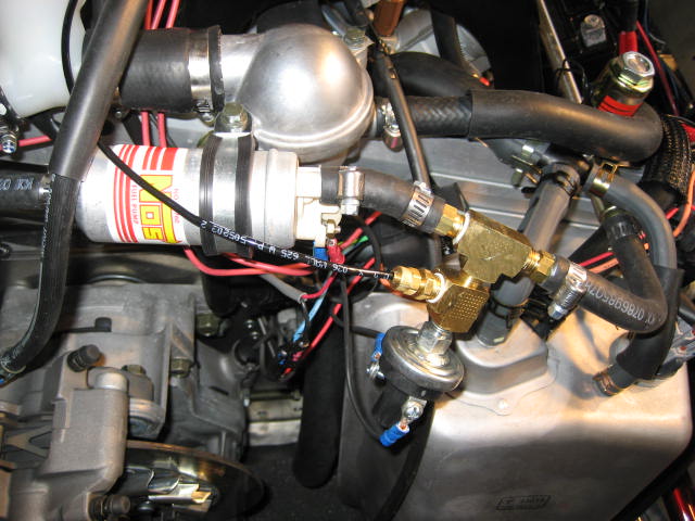

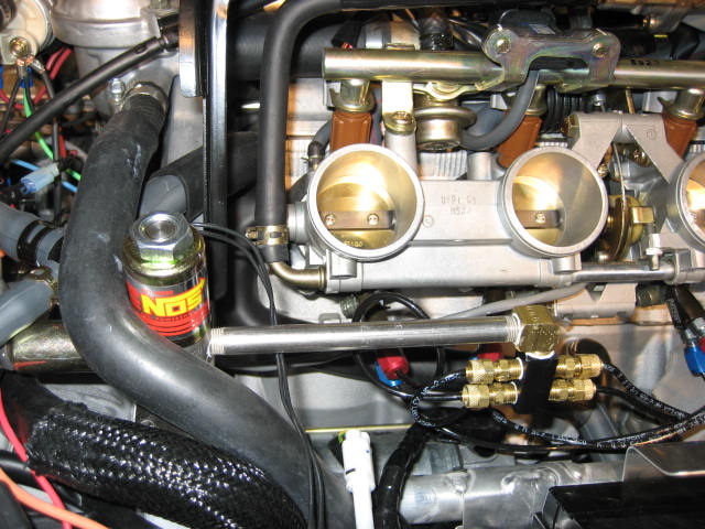

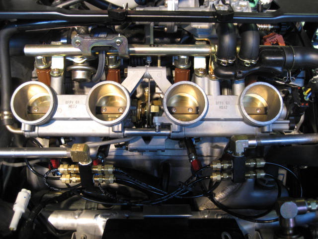

I bought an NX kit from Summit Racing and my Dad and I installed it on his sled. You can install it without the CB tank and nozzle. What I did is removed the throttlebodies and drilled and tapped the stock throttlebodies, some might think thats a big deal but if you want to remove the nozzles later you just use a 1/16" pipe plug to plug the holes. Also to get the nozzle in the clutch side cylinder you need to remove the crankcase breather and cut off a flat section and have it welded by someone who can weld magnesium. I drilled a hole above the fuel pump and ran a dip tube into the stock tank to get an extra fuel line for the nitrous fuel pump. We couldn't figure a way to add a small tank under the hood there just isn't much room. The kit works great and you can run premium in the stock fuel tank for up to 60HP.
Sound like a lot of work? It is, but it was worth it.
After installing NX I decided to use N.O.S. instead on my sled because they use poly lines that go to the nozzles (the jets are in the nozzles) the poly lines are much easier to work with when changing jets. NX uses braided lines and they aren't very flexable. Both kits are installed basically the same.
If you do it this way you can use the stock airbox and you wouldn't have to use K&N filters which I think is what CB has done.
I had to get extra fittings from the local house of hose because the kits are just a generic kit and you will have to do some extra plumbing due to the lack of underhood space.
If you want more info and want to tackle an install like this let me know I can sent pics and help you along the way.

These kits are the way to go for absolute performance and consistency. I installed the kits on Apex Mountains and I've raced a couple of big iron 2 strokes and you should see the look on their faces "IS THAT THING STOCK?" they say in amazement. With a 50 shot I get 1500 rpm's. I just wish I could hold more N2O. I bought an extra 2.5lb bottle cause it goes quick. I'm looking at a carbon fiber 4.2lb that I think I can squeeze in the nose but it's EXPENSIVE. I also heard that if you use a BOSS High Rise seat you can get them with a pouch that you can fit a 12lb carbon fiber bottle in. If that's True WOW you could spray all day without changing the botttle.
