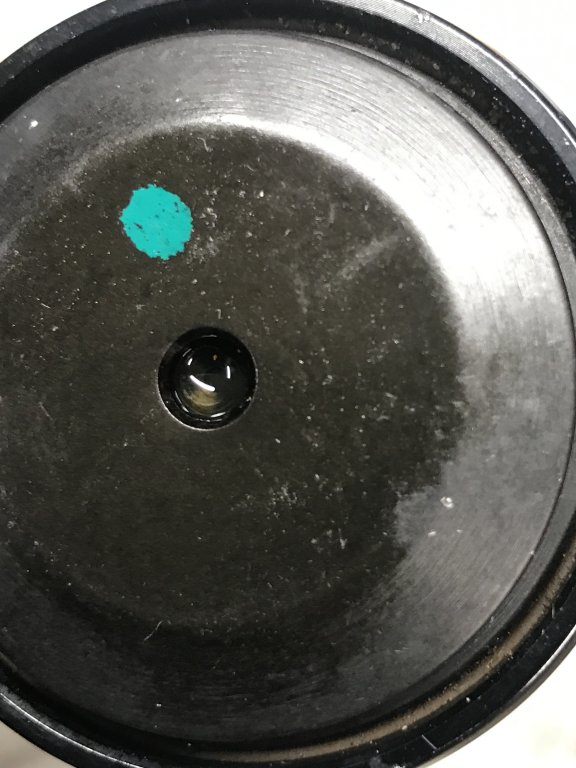

I have tested the nitrogen pressure with stock cap , didn't notice any measurable loss of pressure with over 1000 miles on them . And if you rebuild your shocks every 2500miles the needle caps work fine .
Everytime you stick the needle in there the odds of it leaking go up. There is no secondary seal such as the Schrader cap or a screw and oring like most past needle caps had. I have seen at least a dozen that leaked and they don't always leak immediately after a recharge either. The Schrader caps are just a better way of doing it.I have tested the nitrogen pressure with stock cap , didn't notice any measurable loss of pressure with over 1000 miles on them . And if you rebuild your shocks every 2500miles the needle caps work fine .
Pstn head
How does one know if the nitrogen has leaked out? Rebound or compression go dead or both ?Everytime you stick the needle in there the odds of it leaking go up. There is no secondary seal such as the Schrader cap or a screw and oring like most past needle caps had. I have seen at least a dozen that leaked and they don't always leak immediately after a recharge either. The Schrader caps are just a better way of doing it.
With the QS3's Both rebound and 3 position clicker wont click anymore and if shock is compressed it wont return. Most other shocks the compression clicker will still click.How does one know if the nitrogen has leaked out? Rebound or compression go dead or both ?
Pstn head
Thank you cannondale, that's good to knowWith the QS3's Both rebound and 3 position clicker wont click anymore and if shock is compressed it wont return. Most other shocks the compression clicker will still click.
Here is another Qs3 with this style cap that lost nitrogen through the fill hole needle goes in. Was never touched by anyone other than factory. Those stock caps are inferior. Can even see a little oil leaked through.
