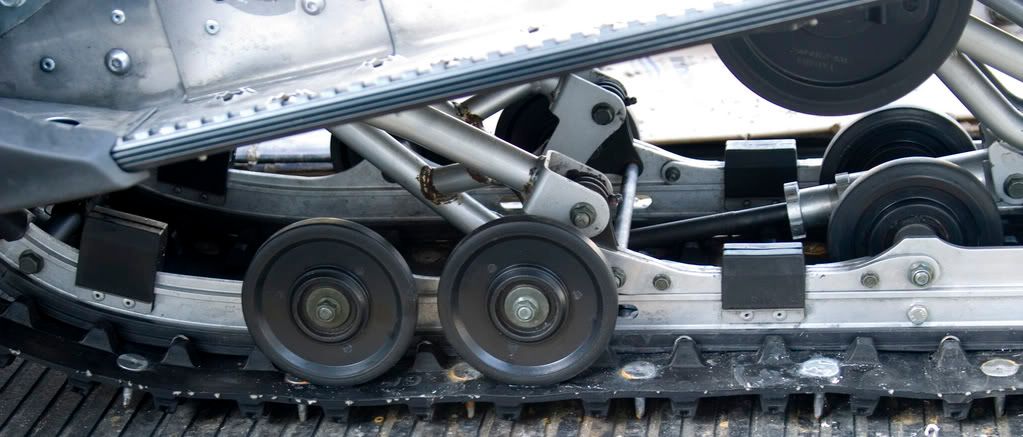

apltx08
Blue Dave said:I do not think that it matters if the outer wheels are 1.5 mm further away from the lugs with the 6205 bearing wheels. The only reason that I would machine them if I ran the 6205 bearing wheels is to use the stock bolts.
I run mine w/stock bolts on my "6205" its the 2nd set of idlers that the bolt is a little short the one on the left in pic, I just use a bit of LOCKETITE on it and is fine...
