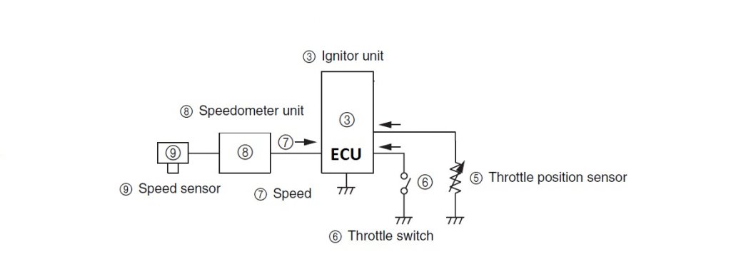

The 07 RS manual states that a malfunctioning speed sensor will trigger the TORS. The speed sensor sends the signal to the meter and then a signal is sent from the meter to the ECU.
- 5,410
- Age
- 52
Correct. A few years ago I was riding one night and came across a stranded apex throwing this code. I noticed the speedo showing a speedo reading(fluctuating), even though the machine wasn't going anywhere. Looked down at the driveshaft bearing and saw the problem. Bearing failed and damaged the sensor.The 07 RS manual states that a malfunctioning speed sensor will trigger the TORS. The speed sensor sends the signal to the meter and then a signal is sent from the meter to the ECU.
