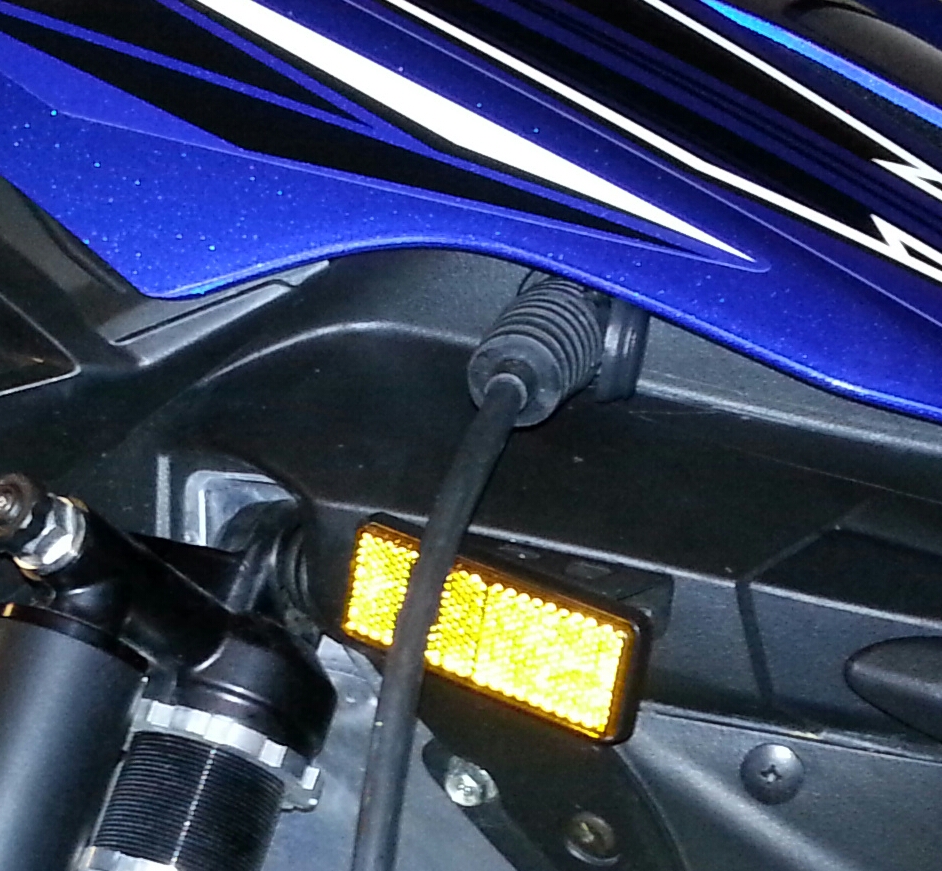

Cable. One hour of installation in -15 C the engine is warm and the warning light turns off in 30 seconds if I use it a half an hour.
