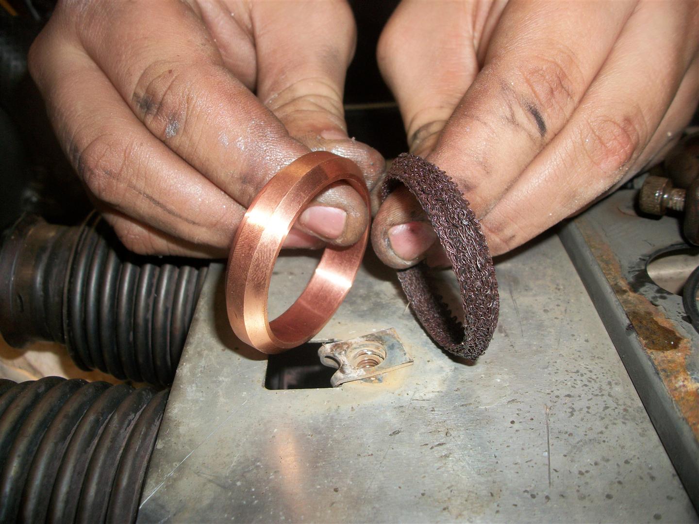

For anybody wondering if they should go with these or not, DO IT! Here's what mine looked like after 6000Km compared to the copper. I didn't think they were leaking since there was no detectable noise but the evidence shows otherwise with insulating material missing/burnt just below it and just mesh left. It was quieter with the copper.
Although we don't hear much about Phazers having leaking donuts, this shows we also have this problem.
