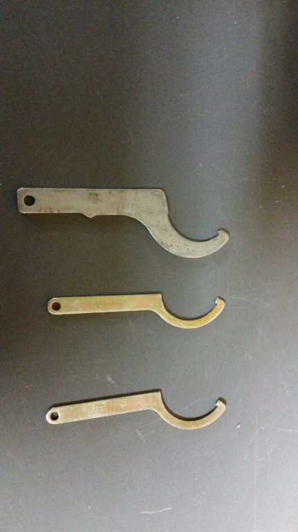

On a similar note, I found this spanner wrench in the back of my apex. It works great on the sw spring nuts compared to the supplied ones. Maybe Travis has some? I'll buy another! I think it's for the control rod adjustment. It's the width of the nuts so goes on and stays on instead of knucklebustin.
Its not the control rod spanner. Found that too..lol
