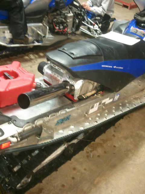

Does anyone have any experience fabbing their own muffler? The way my turbo ended up laying I have it straight piped out the back. I was hoping it was going to be a little quieter than it is but I'm afraid trail riding it is going to create a ruckus.
I was thinking of buying some muffler pack for a street bike pipe, welding some smaller diameter perf stainless, and inserting into my exhaust pipe. Then have a collar that inserts into the back of the pipe and is machine screwed on. Here is a pic of what the pipe looks like now. Does that sound like it will quiet it down enough to function or a waste of time and energy.

Here's what I did. I used a 2.5" glass back that has some good baffles in it. Sleds nice and quiet but you can still hear the turbo.

I just don't want to build something only to be disappointed that it didn't knock down the sound dB more.
I guess with mine being about 15" long and packing the entire length, I should get a little closer to aftermarket dB range.
I was kind of hoping someone would have a trick or tip on welding some kind of baffle here or there that would help more significantly than not. I'm just thinking if I can build a muffler for half the price of an aftermarket bike pipe... I might just as well.
