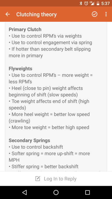

I have dalton thread in weights and am wondering how to adjust them? I threaded in one weight when I added a d&d pipe but now after adding pcv and air box mod I seem to be hitting 9250 rpms on the top end around 90mph. To stop this from happening should I add more weight to the bottom, back the weight I have in there now closer to the top, or add a smaller weight to the top? Any help is appreciated thanks! Pic is of the kit

Yes just add weight to the tip. Either remove what you have in there and put a bigger one in or add.
Switching weight to a bigger one wouldn't effect bottom end though? Since the weight threads all the way to the bottom?
Read this
Thanks! I get the idea of it haha but I mean can I add separate weight to the tip? Or would changing to a bigger weight at the bottom make enough difference?
