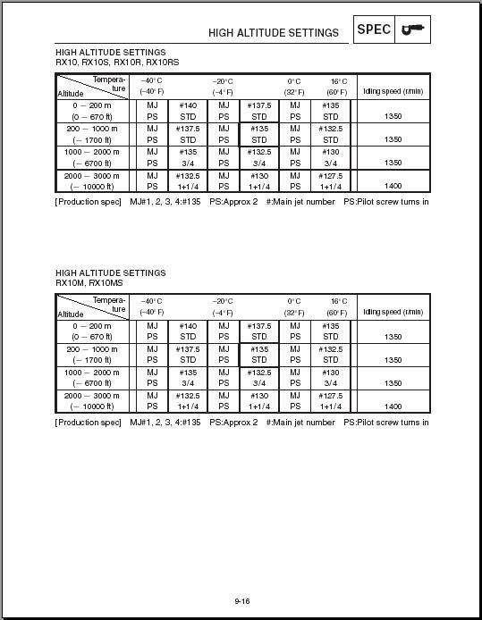

Here is the page about jet adjustments from the service manual:
Unless you are riding in the summer, you should probably go to a 130 or 132.5 main jet and check the pilot screw setting. Also, the 1-1/4 turns recommended is IN and not out.
How do the plugs look? They should be a light to medium brown, anything else means something is wrong depending on the color.
