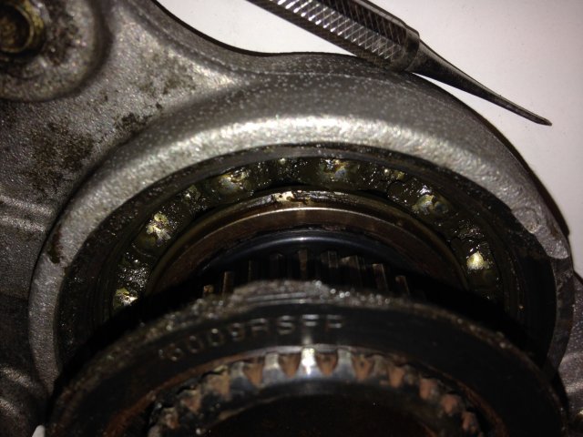

Loosen track. 2 options either split caliper or preferred method is removing 3 bolts in tunnel and removing caliper/disc as one. First split method:
The disc wasn't bad getting off just need to wiggle it off working around it by hand. Be sure to pull straight or you will stick it. Please do this. Both bearings are covered in a dry belt dust ugly grease. No way they will last long under these conditions. A cleaning with WD40 and repack with a good grease yearly is called for. I use a dental pick to carefully pop the seals starting at inner race. Check it out. May consider this nice disc as a upgrade and reward for your nasty work.

Finally great job cannondale now a step by step in the facts page would by awesome !! Did my Apexs every year pretty straight forward. My Viper Jackshaft is done (same as apex) but driveshaft with the brake makes me a little nervous. Jackshaft bearing seemed dry can imagine what driveshaft bearing is like it was always the worst one on my apexs .
Yes I agree. Is odd but mine the jackshaft is worse than driveshaft. Very dry almost pure belt dust. It's a nice Koyo Japan bearing also. Drive is China but at least grease was still moist. The caliper comes apart with the 2 big Allen head bolts. Need to use a rag to catch brake fluid which will for sure come out. When you put it back together you will need to add Dot4 and gravity bleed it to ensure no air. Mine had very little air after this procedure. Use a clear hose to bleed don't forget the brake fluid will bubble up your powder coating.

I wish I could Kodak but it's all together already. Feel free to ask any questions. If anyone feels uncomfortable doing this start with just the Jackshaft bearing I feel at least for this year that is almost mandatory. I don't believe mine would have survived the coming season it was that dry and dirty.
For the driveshaft bearing you will need a good snapring pliers to remove the clip. You will remove the footwell,Caliper guard and the screw holding top of bellypan out. This allows you to pull belly pan side out enough to have plenty of room to use the pliers.

It doesn't hurt to clean the bearing out but sealed bearings are not packed with grease check a new one out one of the biggest causes of bearing failure (on a sealed type) is over greasing as the balls can't roll they skid instead.
