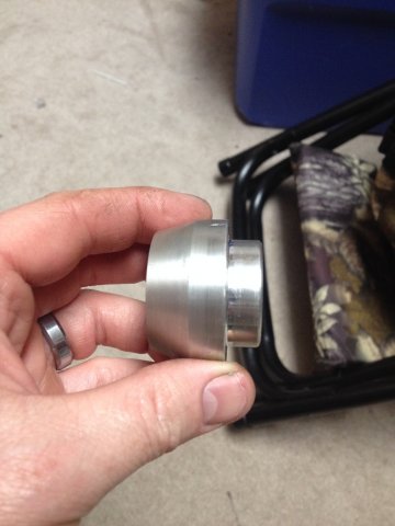

I just split mine and managed to get the seals out without damage (I think at least). The real pain was to get the snap ring back on so off I went to my lathe and made a tapered tool to expand it and slide it back on to the shaft.

For those of you attempting to do this, getting the clip off wasn't that hard but getting it back on was a b***h. Here's what I made to get it expanded so it would slide back on...
The smaller diameter at the right goes inside the hollow shaft and the taper on the left helps the snap ring expand. Next time I have to do this I'll make it out of stainless since the aluminum still had some issues galling.
