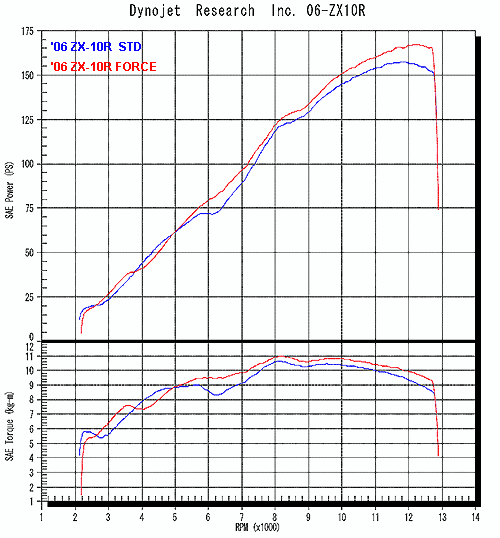

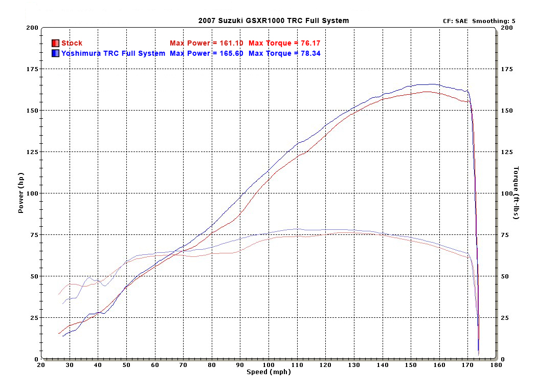

Im sure Yamaha added the EXUP to the XV 1900 (113 cubic inch V-twin)because it needed a low end boost and not because they needed to keep it quiet at a certain speed to pass noise regs. lol.
Four different bikes, of different years, and different brands of exhausts, on different dynos, with 5 things in common. 1. They delete the EXUP device 2. They are louder than stock 3. They match or make more power above 5500rpm than stock 4. They are a 4-2-1 or 2 design not 4-1 5. They are lighter than stock.
Must be snake oil.
