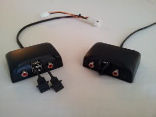

I bought Rockmeisters power distribution kit. It allows two visors and two usb ports. Never know when you need it.
I have one too. Looking forward to using it to power my GPS this year.
