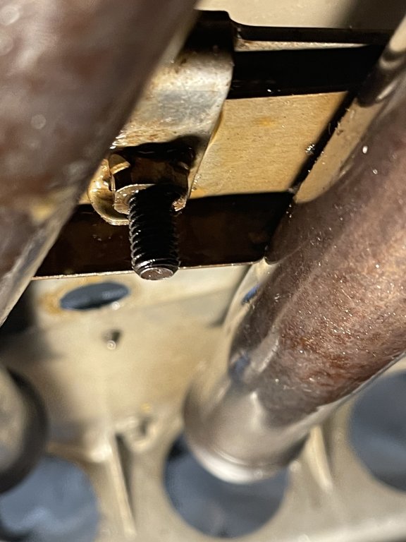

Hi all in this thread. I’m not sure how to post a question, so asking here. I have a new to me 2007 vector with 4600 mile. I am a newbie. I bought the kit from FX garage to replace the donut issue. I took the 8 rivets out of the exhaust hanger. I still need to unbolt the y pipe from the hanger to remove it from the tunnel. One of the hex button bolts came out with pb blaster after a day. The other is stripped. I looked at the bolt from below and the bolt looks like it is missing a small
Chunk so it won’t move. Any ideas on how to remove the last bolt??? Should I drill from the bottom? The top of it is stripped and I broke an easy out in it so I can’t drill from the top and make any progress. //;&@();!!!! 5FC7106D-7C0F-4724-A305-6099D2EAC665.jpeg6CFC445E-2614-4887-9616-5A1596976812.jpeg
Chunk so it won’t move. Any ideas on how to remove the last bolt??? Should I drill from the bottom? The top of it is stripped and I broke an easy out in it so I can’t drill from the top and make any progress. //;&@();!!!!View attachment 172033View attachment 172034
Get socket that looks like and easy out that goes over the stripped head. Use heat on bolt.
Added picture of bolt it is a button head. With Allen head.
