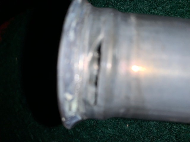

Hi. How close is the hole on the “y” pipe to the flange ? With the F/X Garage works repair kit it may cover the hole. Take a picture so I can see and maybe save the pipes and eliminate the donuts all together.

Thanks, the hole is right at the flange wear the clamp wore thru from spinning. I purchased one off of eBay for 62.00 and will use this with the new copper doughnuts I have held onto for a few years now. This sled is only ridden when my wife rides the XTX which is less and less or I lend it to my buddy when he can go. So if lasts a few years I am good with putting another titanium one on as the other side is ok for nowHi. How close is the hole on the “y” pipe to the flange ? With the F/X Garage works repair kit it may cover the hole. Take a picture so I can see and maybe save the pipes and eliminate the donuts all together.

Picture blurry, but hole can be seen.Hi. How close is the hole on the “y” pipe to the flange ? With the F/X Garage works repair kit it may cover the hole. Take a picture so I can see and maybe save the pipes and eliminate the donuts all together.

You would not need to buy another pipe. That piece get cut off for the flex pipe to slid in and it eliminates the donuts and all the maintenance. If you need more information you can go to fxgarageworks.com
