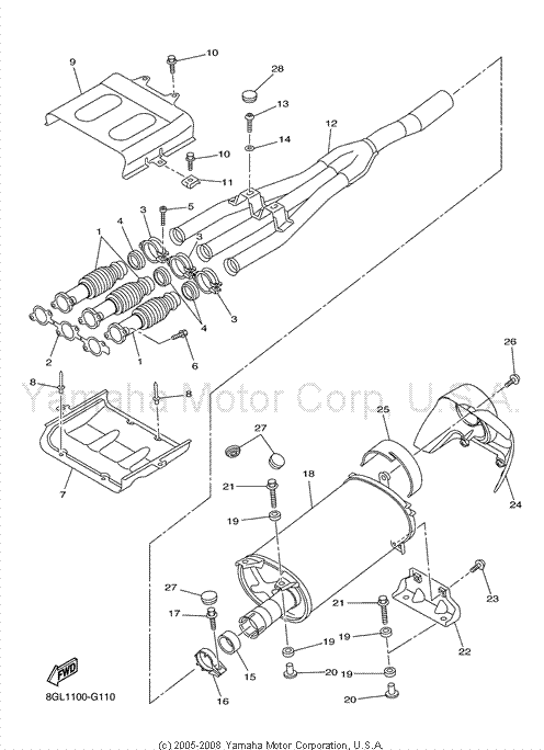

Where exactly are these donuts located? I'm assuming they are the exhaust gasgets at the tail end of the header that connects to the exhasut pipe. Is this correct?

Yes, that is them, directly below the gas tank.

Unfortunately the Exhaust donuts are continuing to be a weak link to the motor/emissions on Yamaha sleds. The good thing is it’s about half the work to inspect the donuts on the Nytro as it is the Apex. Actually if you were just checking you could probably get to them in about 10-15 minutes. Not happy about this though I really thought with the stiffer chassis that the Nytro’s would hold up much better. Maybe it’s not so much the flex as much as the heat that really causes these things to breakdown.
