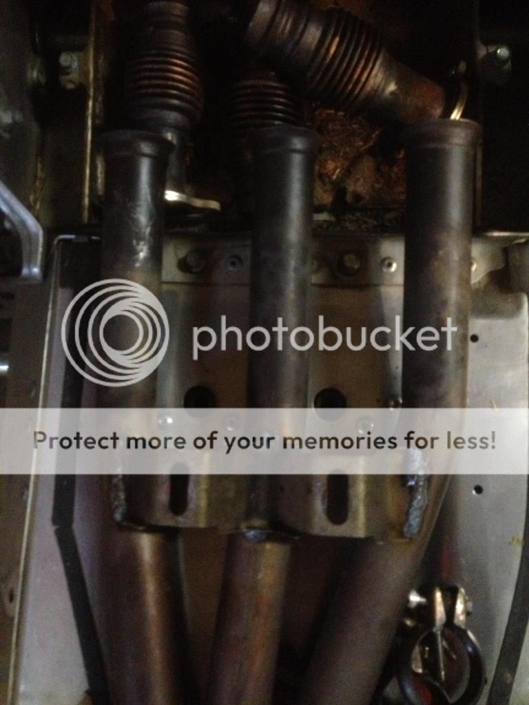

No, the clamp where the two holes line up go between the header pipes. I will post a pic from my son's sled in a moment since his is apart replacing the donuts............09nytro24 said:Do I have to worry about drilling a hole in my header pipe if I drill these bolts out? I have so far broken 2 bits, and I am having a very rough time even being able to drill into these bolts, the must be hardened steel.

Here is a pic from my sons sled where the header is out sitting on top of the tunnel. You can see the holes go between the header pipes. You will have to drill out the studs by starting small and you may collapse the screw as you dril larger. Otherwise drill out and re-tap. I know it sucks right now but it really isn't bad if you have the right bit that drills through steel. Let me know if you need any other pics since my son's sled is apart waiting for manifold gasket to arrive.....

Thanks, I just went and bought some good drill bits, hopefully I can get it. The nut appears to be welded onto the bracket, correct?

Yes, the nuts are welded... Ouch!

Yea I didn't do that...and now the y pipe won't come out...I thought the bracket on the y pipe was the portion that had the welded nut, but it appear to be a separate portion, which will just make this suck even more.
Is there a trick to getting this y pipe out? It looks like its sort of locked in there by the bracket riveted to the tunnel.

The y-pipe has to slide forward before it'll drop down from the bracket. The bracket underneath has fingers that hold the manifold up, and the fingers are pointed towards the engine. Hopefully that makes sense.
