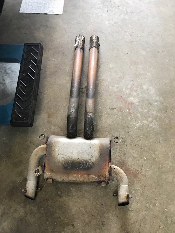

Clamps soaking with PB Blaster to aid in removal. And aftermarket exhaust is out. No clamps. WTH. Is that right? Doesn't matter as the new one I have to install has the clamps on it...I'll wait to put that in until I make sure I don't need to do any donut work.
