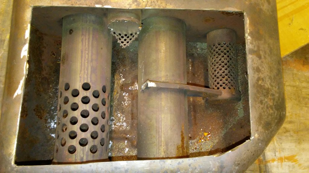

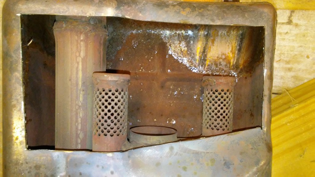

Ulmer told me how he did it and I am sure he would do same for all. I believe the chamber has a real small hole and he puts a pipe which is much bigger where that hole is. 2" rings a bell. Dont get me wrong its better than stock but not a straight through design.Does anybody have a pic of the inside of a modified stock muffler? i'm sure we could modify it, but it would be nice to know how to get the most out of it!

View attachment 137620 View attachment 137622Does anybody have a pic of the inside of a modified stock muffler? i'm sure we could modify it, but it would be nice to know how to get the most out of it!
I modified my own last year just by cutting off the chambers with the small holes and drilled extra holes on the inlet pipe. I was just wondering how the professionals did it for max horsepower! I have a D&D trail can that is nice, but wanted something a little quieter and not lose much horsepower!
