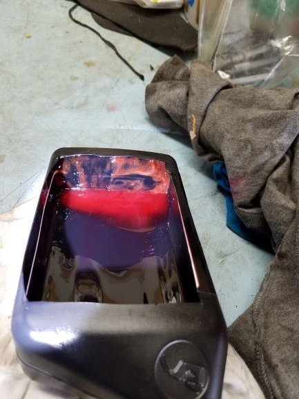

JPS - might want to cut open and look into the bottom of Klotz bottles (especially if you have any oil that has been sitting around for a while) to make SURE there is no residue/goo/ gunk/sludge in there. I USED to be a Klotz rider but after an episode of that, I went away from them. I hope yours is ok. The pic is 2-stroke oil bottle with side cut out.Hi miles trail rider here with tuned Sidewinder 0-30 klotz

Doo 1200
That's the wonderful smell settled to the bottom...lolJPS - might want to cut open and look into the bottom of Klotz bottles (especially if you have any oil that has been sitting around for a while) to make SURE there is no residue/goo/ gunk/sludge in there. I USED to be a Klotz rider but after an episode of that, I went away from them. I hope yours is ok. The pic is 2-stroke oil bottle with side cut out.
