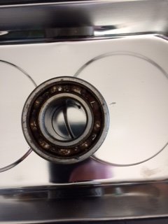

I regrease the jack shaft bearing every year. Just did it. It looks super clean. My sled has 20,107 miles on it and still the same bearing. I change the speedo bearing every other year, around 7 to 10k miles for me. But it also gets cleaned and regreased yearly.

Great post thank you. When you pull the bearing seal off ,doesn't it crack ever or break? Also how do you get that to seal back up so it is basically water tight? Also how many times can you do this before the Yamaha Bearing just needs ro be replaced?After about 3500-4000 miles of mostly "clean snow" riding(no snirt) I checked my Bearings....as most have said the Jackshaft bearing wasnt too bad,however the driveshaft bearing was pretty nasty....
If this is done seasonally,I doubt you would EVER have to replace either of these.
here is what i did....and how easy it was to do,taking very little time...I will definitely be doing this every season now.....
Tools needed are snap ring pliers and also i used a dental type tool,to POP off the covers...clean the bearings with something like wd40(not brake or carb cleaner) then add grease.
Remove belt,remove secondary(14mm bolt) and be sure to take note of all SHIMS/washers on the jackshaft,as there will be some infront of secondary and behind...be sure to put back together exactly same.

What about the bearing on the other side in the chain case side. Does that need to be teplaced??well YES and NO....
you do need to do all the above PLUS you need to get underneath,and at the set screws,as mentioned above....they are not the simplest thing to get at sometimes....but can be removed,then the bearing SHOULD slide off the end of shaft.....
the reason I say "should" is because ive seen them where they are RUSTED onto the shaft pretty badly...and can be a real prick to get off....
That is why I wanted to post this....My thinking here is if you do this once every season,or whenever you FEEL its needed,you shouldnt ever have to actually change the bearing for a long long time....
the time to do this was VERY QUICK....once you got the secondary off,its a matter of minutes only to pull cover and clean/grease her up....I did both bearings and had all back together in less then 15 minutes....youll never change out a bearing that fast.
