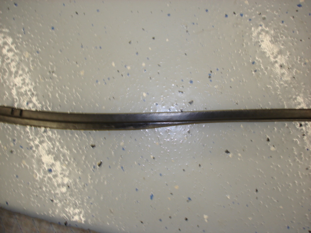

Well I pulled out my standard slides which were worn down to the wear limit line wherever there wasn't an idler wheel. You can see in the attached picture how much the small marginal snow wheels at the front of my rails helped and how much the slider is worn right behind this area. This was after only 70 miles of riding in poor conditions. I realize that standard slides were quickly initially and then they stay virtually the same for hundreds if not thousands of miles.
However I wanted to try the Dupont slides and be done with slider wear altogether (or so I am told) so I put a set on. I will let you guys know if they work on the fully clipped Ice Ripper XT as I am planning on putting on a couple of hundred poor condition miles this next weekend.

There is a similar thread on here now and my comment is that I went from a center studded, partially clipped Predator with very little slider wear to a fully open and clipped Ice Ripper similar to yours and wore a hole in the sliders after about 300 miles. I added ice scratchers and the Pioneer wheel lift kit and it seems to have gone away. My wear was not so much at the bend but a little further back.
