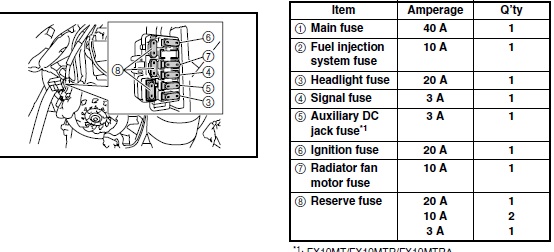

Somewhere in your guages, backup buzzer, brakelight switch. That's where to look if it was an apex but not sure if wiring is similiar

Found the issue. Melted wires near the turbo.
