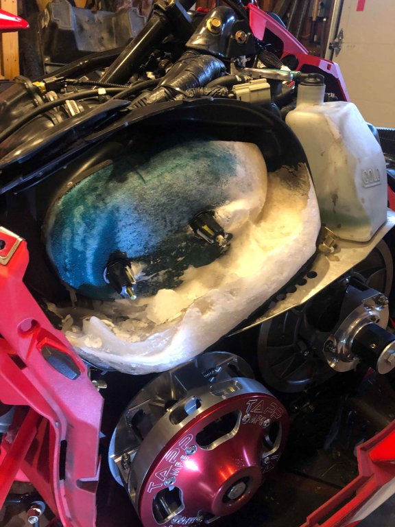

I ran the GAP intake most of last season. We did a long weekend trip and noticed I was down on boost at bit. After I got back I opened up the airbox and found this in my airbox. 100% trail so must have been all the snow dust kicked up from following the sleds in my group.

Oh snap I have some camp dry spray that I used on my 1100 with evo intake, maybe by the looks of things I’ll spray some on the gap intake screenI ran the GAP intake most of last season. We did a long weekend trip and noticed I was down on boost at bit. After I got back I opened up the airbox and found this in my airbox. 100% trail so must have been all the snow dust kicked up from following the sleds in my group.

Wow!I ran the GAP intake most of last season. We did a long weekend trip and noticed I was down on boost at bit. After I got back I opened up the airbox and found this in my airbox. 100% trail so must have been all the snow dust kicked up from following the sleds in my group.
I will definitely have to keep an eye on my intake this season!
I may rig up a way to block the Gap intake opening in adverse conditions.

Maybe a layer of frogskin over the GAP intake screen would help with the fine snow dust that seemed to have gotten into my airbox. Again, this happened to me over a weekend of 600 miles and following fairly close to the sled in front when not leading.
That's what I was figuring could happen with the stock coarse screen up front.
The reason I asked about plugging the stock intake entrance is the area behind the windshield would have a negative pressure behind it vs the high pressure at the front of the hood area the GAP intake breathes from.
To me any pressure you build from the high pressure area up front, would just diminish to nothing if left to "vent" to the low pressure area behind the windshields stock intakes. After all, all were looking for here is the high pressure and cold air to benefit the intake charge. Not that its a large difference, but to me it would seem you would want to block off the low pressure area that is the stock intake and let the high pressure front scoop slightly pressurize the air box in effect.

That makes sense to me. I might try blocking the low pressure area of the stock intake and try that. Need to figure out a way to put a better screen on the stock intake as well to prevent the snow/ice buildup I had last year.
