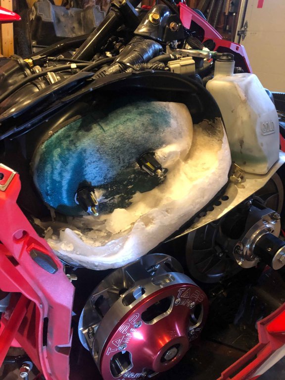

I’m gonna get some measurements and see if a frogskin will fit the screen, thanks for your pic,That makes sense to me. I might try blocking the low pressure area of the stock intake and try that. Need to figure out a way to put a better screen on the stock intake as well to prevent the snow/ice buildup I had last year.

I think Frogzskin would work.That makes sense to me. I might try blocking the low pressure area of the stock intake and try that. Need to figure out a way to put a better screen on the stock intake as well to prevent the snow/ice buildup I had last year.

Moral of the story is - gotta be leading lol.I ran the GAP intake most of last season. We did a long weekend trip and noticed I was down on boost at bit. After I got back I opened up the airbox and found this in my airbox. 100% trail so must have been all the snow dust kicked up from following the sleds in my group.
