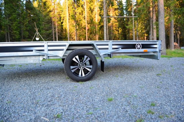

Got myself a new trailer to haul my Nytro.
SteelerJim
- Dec 6, 2010
- 350
- 34
- 488
- Rockton, Pa
- 2011 Nytro XTX
Those Yami trailer wheels are cool!
