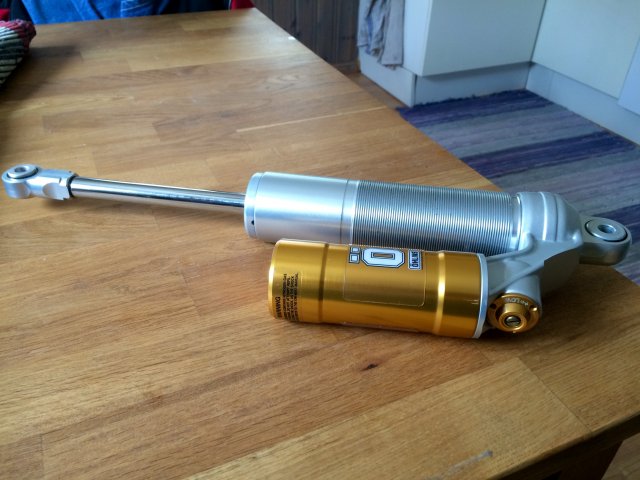

One shock out and cleaned.

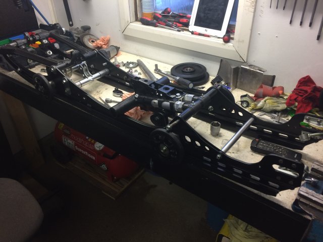

Rear shock out and cleaned. The skid is completly apart now and I clean and polish everything right now.

Today I started to put everything back together again. Everything cleaned and polished. Do still have to wait for some parts that I ordered.

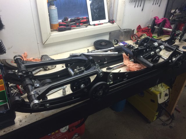

Some progress. Looks nice with all the black.

Getting close to done.

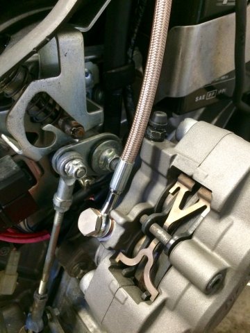

Added a new brake hose today.

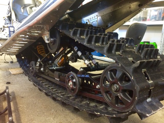

Installed! My wife had to help me to get it into the track.

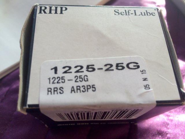

That bearing did I get for the drive axle clutch side.

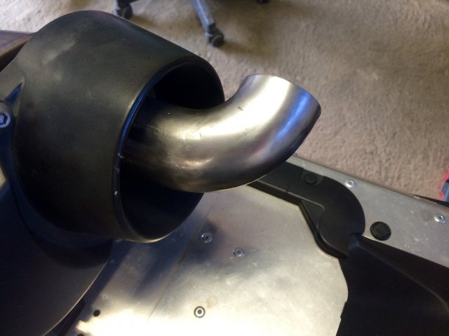

Added this to the sled today. Got a pipe bend from a local company instead of the Yamaha original. Cost: 14 USD.

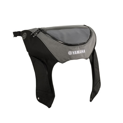

I ordered the tank bag deluxe and a black Viper flap from my Yamaha dealer today.
Hope they will arrive soon. Looking forward to the winter now!
