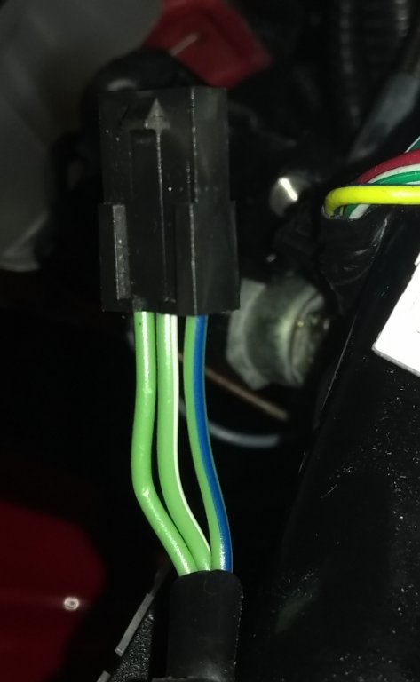

Checked mine. it has 3 wires, Green , Green/white and Green/blue in this order in the picture. this only ohmn reading i'm getting is between green/blue and Green/white of 11.2. what are you thoughts?
Allan
Is it correct to say green is the common wire and it broke?
Allan
Took the right side apart to see what the reading were and I get reading from green to green/white and from Green to green/blue. So on the left side the green wire must be broken. was hoping i could fine the brake and repair if it was out side the element but for that I would have to get the grip off.

Yeah, it looks like your on the right track the Yellow is for testing further upstream in the harness.
Green= common or ground
Green/white is low heat with approx 14 ohmns resistance (between Green and Green/White)
Green/Blue is high heat with approx 7 ohmns resistance (between Green and Green/Blue)
