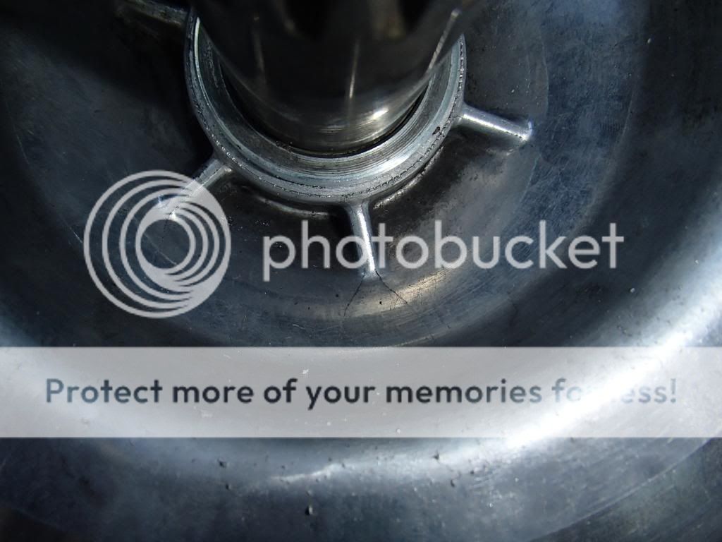

Rough looking centre of sheave
These little V marks are fisible coming off each of the "fins" of the sheave. They are the exact same around the clutch but want to be sure

Those marks are fine. Just there from casting I believe. Mine has them as well. Also, don't polish the sheaves. You can take scotch-brite to them to "roughen" them up. Always move the scotch-brite pad from outside to inside of the sheave, or an up and down motion. You want the belt to grip, and if its polished it is more likely to slip. I also put a very light coating of grease on the bushing, but most people here assemble them dry.
