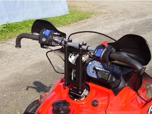

Does anyone ahve any info on some heated grips for a sled I changed my 03 bars to the sno-pro bars and need grips i had wanted to use the 06 yamaha grips but they will not work.And i dont want the 03 slippery grips anyone used others thanks dave
I used the Cat grips too. Had to wire another circuit straight off the battery with a Cat switch. Then you gotta wire a 4 ohm resistor into the stock Yammi wires to fool it into thinking the warmers are still connected. Works great and looks SWEET!
