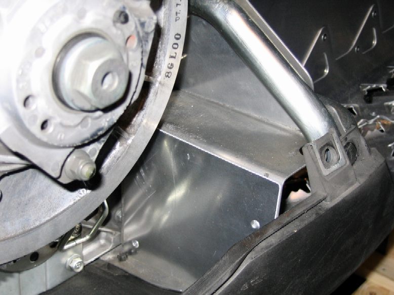

therte is also a plate u can buy from yamaha, dont rmember the part number, but i got it put on when i first got mine and it helpd a lot. billymx where did u put the duct tape? on ur boot or on the sled. like i said the plate helped from yamaha but it still gets a lil wet in the deep stuff.

I'm thinking about removing the wet foot plate on my 2009 because I don't want to ruin my clutches when the plate gets mangled because of a blown belt. From the above pics it looks like the roest skid plate covers the problem area...anybody with an 08 and no plate running a roest skid plate see an improvement with their wet left foot??

Took that plate out and never got a wet foot no duct tape either , O yea i got klim boots to

upei93 said:I'm thinking about removing the wet foot plate on my 2009 because I don't want to ruin my clutches when the plate gets mangled because of a blown belt. From the above pics it looks like the roest skid plate covers the problem area...anybody with an 08 and no plate running a roest skid plate see an improvement with their wet left foot??
I'm with you on taking that out. That "wet foot plate" is a disaster waiting to happen, as more and more people are finding out.

I took mine out, or maybe I should say my belt took it out. Luckily all it did was mark up the secondary with a few nicks and scratches. Nothing serious, the plate looked like it went through a meat grinder. Left it out and just delt with the LBS. This year new boots, HMK waterproofs. Can't wait to have dry feet again.

upei93 said:From the above pics it looks like the roest skid plate covers the problem area...anybody with an 08 and no plate running a roest skid plate see an improvement with their wet left foot??
I'd like to get some more input on this. I have always run my 09 without the Yamaha wet foot plate and my skid plate. I had always wondered what the wet foot problem was, because I've never experienced it. I think you may be right when you say that my skidplate "seals" up the bottom of the sled better than the flimsy OEM piece. It would be cool if this were the case.
