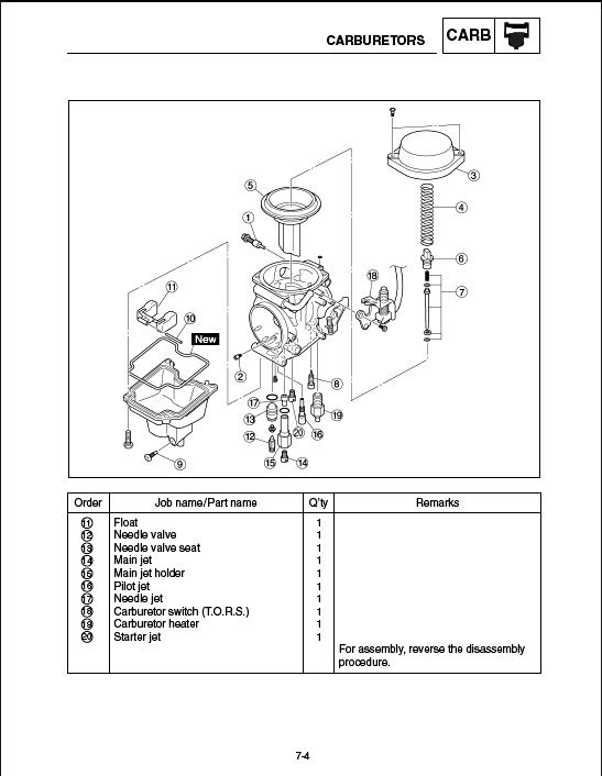

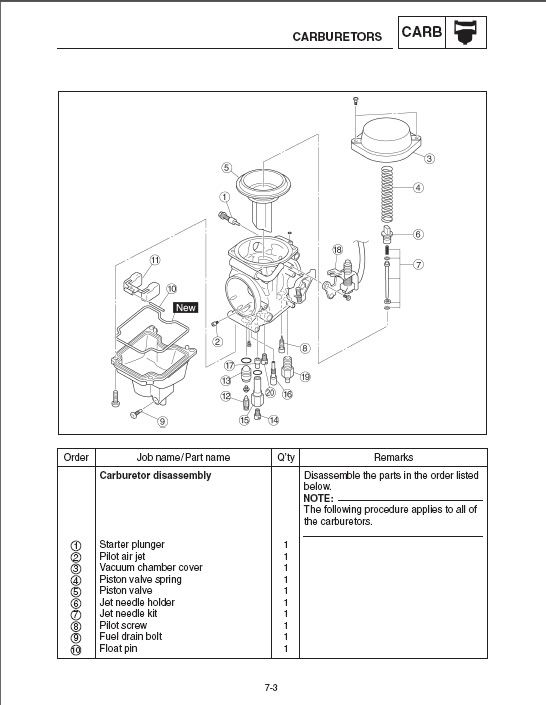

RedRocket said:Sounds like the carbs were not put together correctly. They are opened via vacuum so if there is no vacuum or the Piston valve/spring was not put together right, then it will not open and suck in air/fuel.
Here is an exploded view of the carbs from a 2003 RX-1 service manual:
click thumbnails for larger images
thanks, im going to go thru the carbs tomorrow
