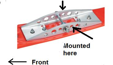

The previous owner installed USI Triple Threat X2 skis. First thing I noticed was that they're bolted on to the spindle one hole BACK from the center position. Is this good? In other words, the skis stick out forward a little further. First thing I thought to do would be to put them in the center hole (unless this is where they should be). Hope my crude pic below helps.

The skis you have are pretty aggressive which isn't exactly what the Nytro needs (yet better than the stockers) and I think you have them mounted in the position that will provide the easiest steering of the 3 choices you have. You could also try shimming the ski rubbers to reduce the ski pressure as well. link: http://www.totallyamaha.com/snowmobiles ... r_Shim.htm

I was certain that putting the skis in the middle hole would make turning them easier but I may be wrong. Might try to experiment around a bit.
