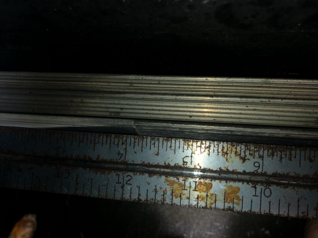

oh man, what a disaster if it takes so much reaching to fix a hose...lookslike the machine has to be almost ripped down completely...what's the fix to avoid this? A BOP tunnel protector? Do I got this right?
https://www.barnofparts.com/coolant-hose-saver
If you already have the yamaha tunnel protectors installed then yes put the bop savers on!
Or like NYturbo mentioned stm full length tunnel protectors or just the front stm protectors if you have the yamaha stock one already installed on rear

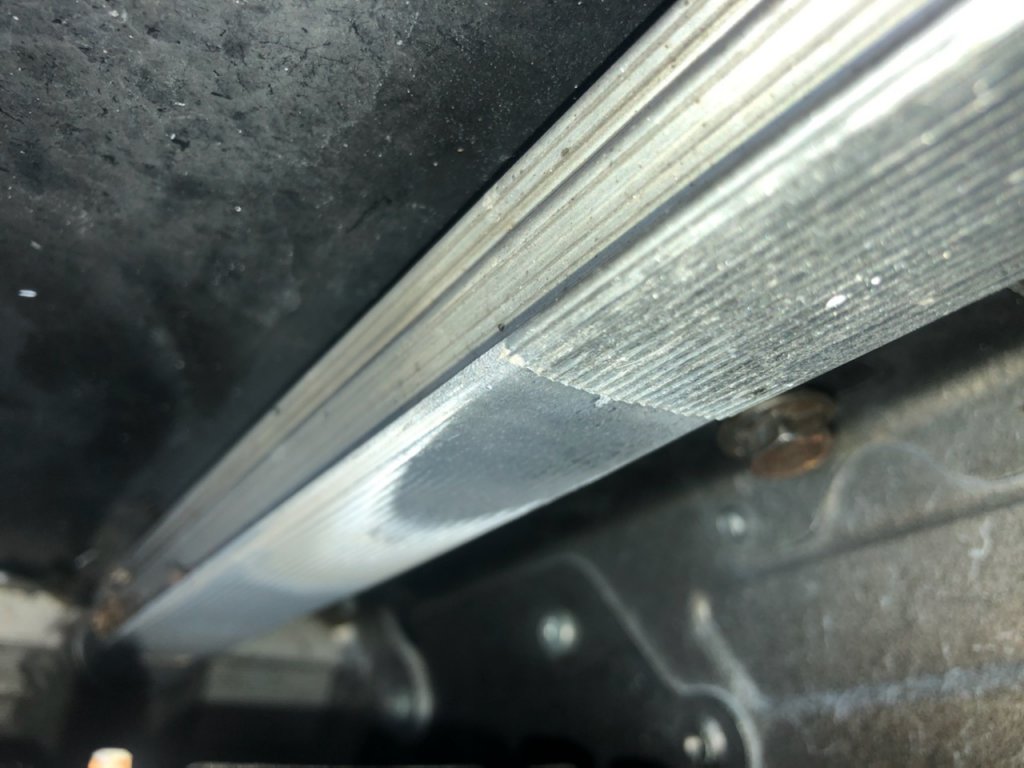

Thanks for posting. I run those also. Could you wedge a small thin piece of rubber at the back of the guard where it rests on the exchanger? That would give it a touch of space and keep the two aluminum surfaces from contacting.
MS
RAMSOMAIR
Precisely! I'm going to contact cement a thin strip of EDPM rubber inside the full length.
fullshift
- Mar 8, 2004
- 43
- 878
- Manitoba
- 2017 ZR9000 Limited 129
If we added a flat washer to the bolt between the tunnel and hose protector would that be enough clearance?
RAMSOMAIR
BINGO!If we added a flat washer to the bolt between the tunnel and hose protector would that be enough clearance?

I am in a similar boat, caught a coolant leak while doing spring maintenance and traced it back to a nick in the hose and a loose fitting...
I am putting a BOP order together today.

Are you going to replace the hose also?
I am uncertain if it is only cosmetic or actually leaking right there. I ran the motor and heated everything up a few times to pressurize the system today and everything appears to be holding together. No moisture at all after tightening the hose clamps.
At the same time if that blows I will be stuck in the middle of the national forest on the wrong side of a tow rope...

take a close look at the gouge that hose is very thin.I am uncertain if it is only cosmetic or actually leaking right there. I ran the motor and heated everything up a few times to pressurize the system today and everything appears to be holding together. No moisture at all after tightening the hose clamps.
In your pic it looks wet around the gouge
It was wet there when I took that picture. However, I wiped it off with some paper towel and after two thermal cycles it was still dry. I am not sure how it was actually leaking to get wet around it like that and stop now. In all likely-hood as cabin fever (due to the virus) sets in I will be doing that coolant hose and every other thing that can be done on the sled.
I do have coolant hose savers and some other stuff on the way from BOP though.

mine was cut from the inside due to the nipples getting out of alignment. I would consider taking and inch out of the rear exhanger so the nipple is back and ich and reweld, allowing some flex. then a cover
