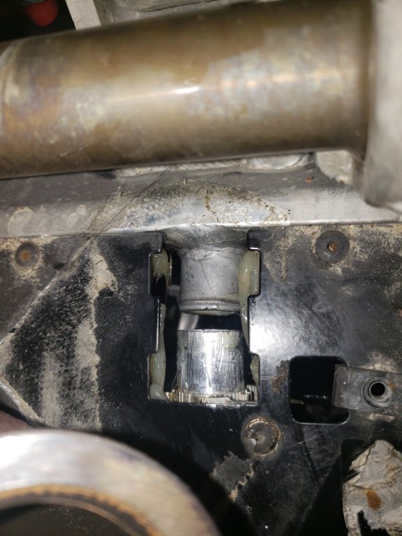

If you didn't have a leak on the stock hose I recommend either adding bop hose protectors, or getting stm tunnel protecters or making your own cover if you are handy!! Why drill out all the heat exchanger rivets if you don't need to???
Already protected mine.
- 7,868

Now all ya need is the chaincase beefer up bracket that comes on the race sleds. Looks like the PERFECT time. 500 miles from now, thats what mine will look like.
Tell me more about this chaincase beef up bracket. This repair and hose protection I did last fall.
