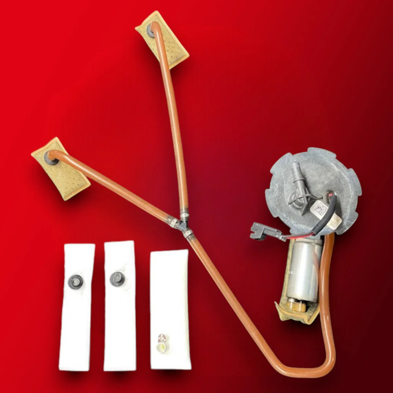

Could the reason you’re eating pumps have to do with the pieces you’ve found in the tank perhaps Glenn? Not that they’re being eating thru the pump but because something is not working as designed.

Could be Mike, however the socks and filter in the slipper did not appear dirty.
Maybe at next pump replacement I should run carb cleaner through these filters and check for debris??
Should I go out on a limb and change the two socks? I'm open to any opinions.

Have had good luck with Deatschwerks fuel pump #9-401-1046 also i clean my fuel sock and crows feet with carb cleaner before each season.

It's a foregone conclusion that if we ask someone who sells larger pumps IF the stock pump can handle 300HP they'd all say 'no.' That said, I've been told the stock pump becomes marginal starting at about 280HP level. Certainly should not be used higher than that.
I purchased the PEFI fuel pump upgrade kit years about 4 years ago. I think he uses a 255 lph pump. When I did the calculations using stock fuel injectors at full flow, even that 255 lph pump can pump way more fuel than the injectors can flow, which means there is still a huge return to the basket keeping it full and overflowing all the time.
Some of us have added an in-line 10 micron fuel filter to our systems making certain nothing can clog up the pump or the suction socks, etc.
I've also had my injectors ultrasonically cleaned and flowed to make sure they're at 100%.
So far, no issues with my PEFI pump and fuel filter. Also, good idea to run the pump directly off battery using the Boost Kinetics relay accessory.
PEFI also has larger tank suction screens if you want. Don't know whose pump they use. Kit is expensive but it's a really nice quality kit.
BTW- no, I don't work for PEFI but their hardware is the best around IMHO.
But if the pump won't keep running right, no one's pump is any good. JM2C
