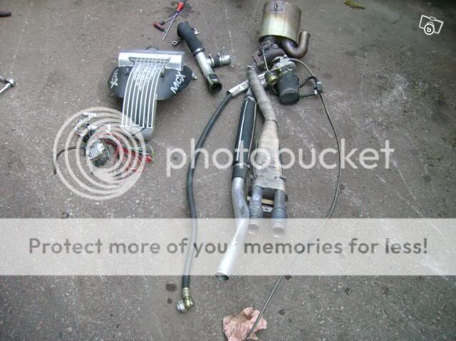

By the way my air filter had sucked in a lot of fibres from the heat wrapping that was around the exhaust pipe. Several loose hose clamps had damaged the wrapping.
Had to remove packed fibres from the filter. Some fibres had gone through the filter and it looked like the turbo fan had som minor damage, but I still get good pressure.
Not my kit but it shows the heat wrapping
