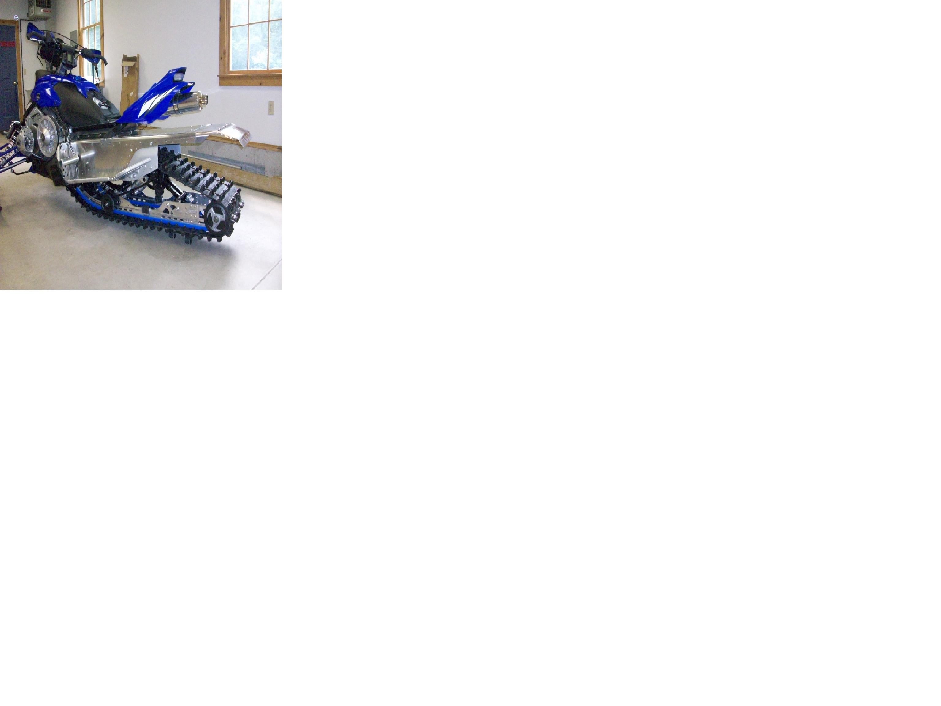

I extended my 09 RTX to 136 and I'm working on a tunnel extension, I'm just trying to figure out how much longer it needs to be than stock. I've read that the stock tunnel will accomodate a 133 inch track, so is 4 inches enough?
I'll post pics when I get it closer to together.
I think I went 6" with mine, maybe more. If you think about it the track is now 7.5" longer than stock. so to make it look proporsional to stock it would have to be 7.5' longer. Just play around with it untill it looks good to you.
wayfastkev
136"
I made mine 7.5" longer.
