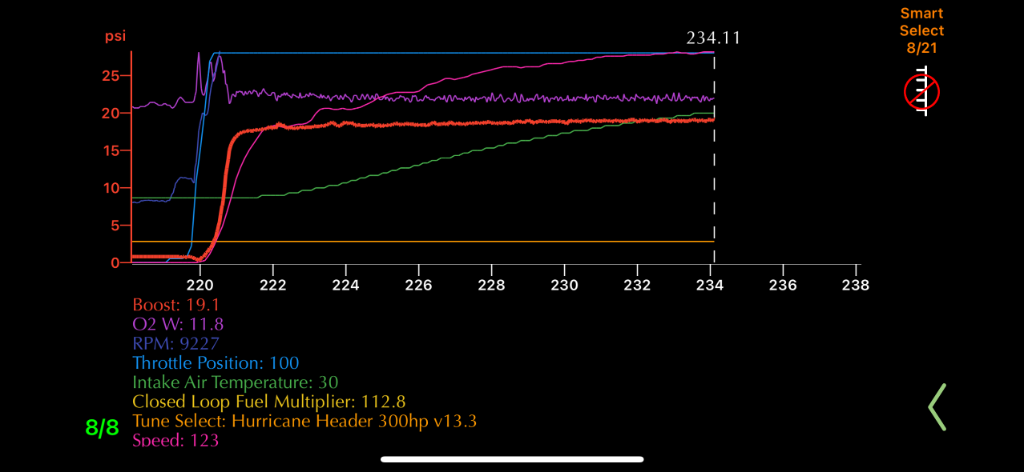

I will data log the 300hp tune with stock fuel pump, Closed loop so i can also watch correction factor. If the tune is good and clean the wideband should never correct more than 10-15% either way from commanded Lambda.
I believe closed loop will only correct up to 125% so after that you're pushing your luck. I would not have knock protection flashing before i installed the larger pump but it would constantly be pulling timing. Remember these tunes are all a bit different and Dave's tunes want to run rich. Highly recommend the AFPR and monitor closely if you're doing any long high speed runs without putting the bigger pump in.I will data log the 300hp tune with stock fuel pump, Closed loop so i can also watch correction factor. If the tune is good and clean the wideband should never correct more than 10-15% either way from commanded Lambda.
Side note, i was running the Header tune this year and it would still be correcting fuel up to 110% @ 53 lbs key on with the bigger pump.
I am at 50psi key on fuel pressure on my Hurricane Header tuned SW and it is correcting fuel up to 114% as well on the 300tune to have 11.8:1 AFR.

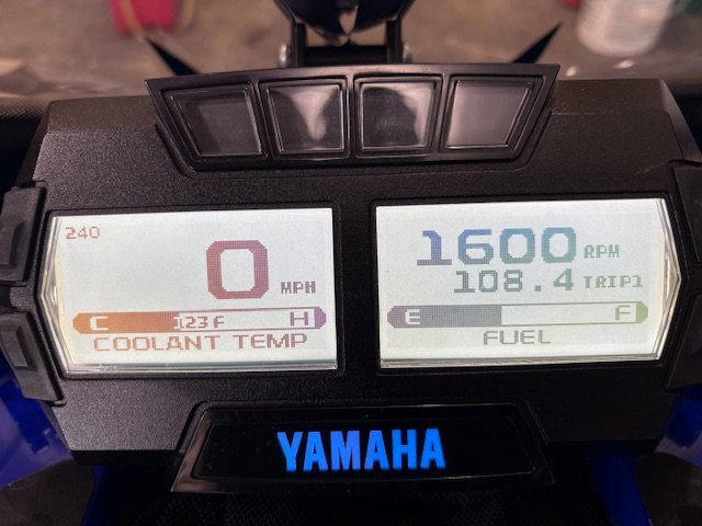

As a side note....I just did a full day back woods trail and lake ride and before the trip I adjusted my FP down to the stock 43 psi as I was going to be a relatively low rpm and speed all day on the 240 tune in the operation envelope where the closed loop isn't always active.
We did over over 100 miles and the sled used only 18 liters/4.8 us gallons....great mileage.

What is the total intake temp gain on that pull? What intercooler?I am at 50psi key on fuel pressure on my Hurricane Header tuned SW and it is correcting fuel up to 114% as well on the 300tune to have 11.8:1 AFR.

I have no place that I ride where I could hold 100% throttle for 14 seconds!I am at 50psi key on fuel pressure on my Hurricane Header tuned SW and it is correcting fuel up to 114% as well on the 300tune to have 11.8:1 AFR.
