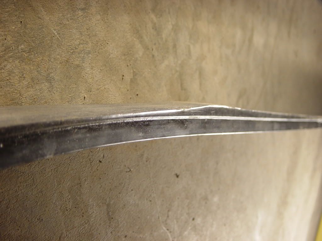

OK, I ordered the marginal snow wheels but now I'm second guessing myself. After looking closer at the sliders the only place the front wheels helped was at the wheel location. so If I add wheels I'm going to stop the wear at that location. Unless they go back to all wheels that articulate with the terrain we're going to see wear. The rails are ridged and trails are uneven so the pressure continuously changes through the humps, bumps and dips. I still believe the aluminum rail start sinking heat from the slides and slows the wear, not the wheels.
The pictures show how the sliders wore in front and behind the front idler wheels but not at the wheels. So do the idlers slow the wear?
